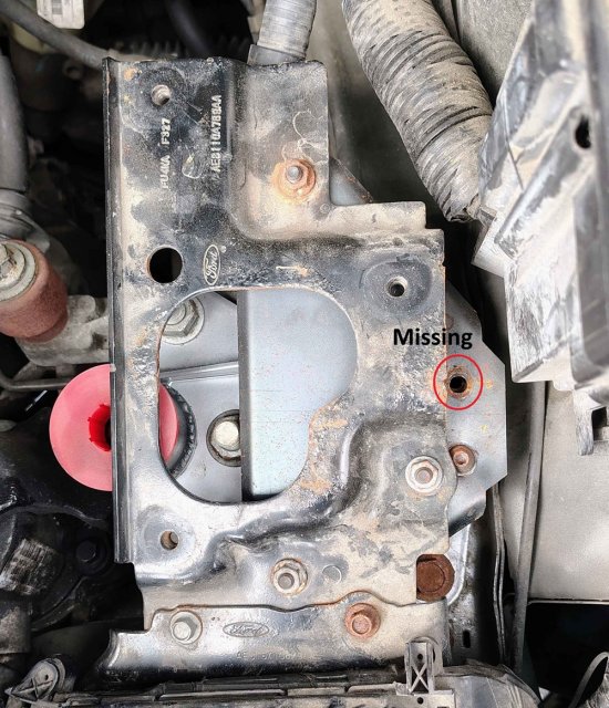

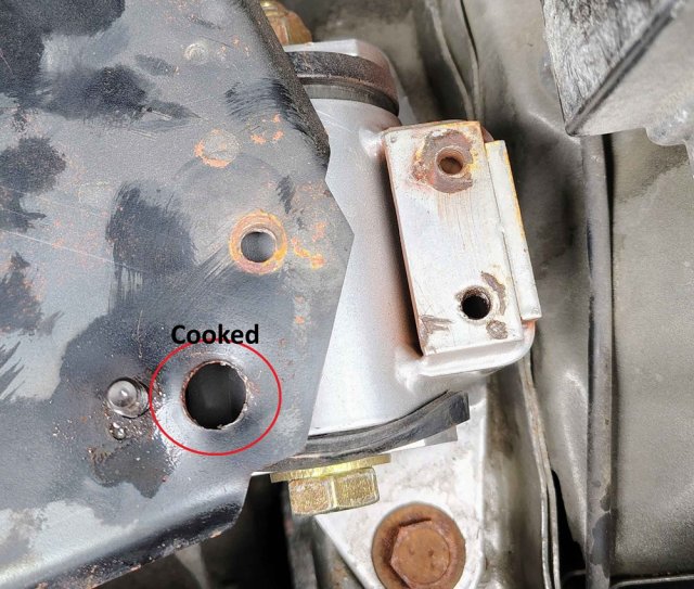

Isn't there 3 bolts for the tray? Or do you have an aftermarket tray?
Aftermarket tray, It's for the AWR 88A mount. And it is toast. One bolt was missing and it was sliding around like crazy. Wasn't moving like this before the event when I did my checks. Not the worst outcome, but it was absolutely sliding around and with the short shifter it was within reach easily to bump it from 2nd to neutral during hard left hand turn braking. I contacted AWR to see if they carry extras I can order. Though I'm sort of just tempted to relocate the battery to the back now.
View attachment 69862 View attachment 69863
Well shit not what I expected, how are the threads on the mount? I'm sure you can grab a bolt and washer from ACE if AWR doesn't come through...
I took some extra hardware and bolted it back together for daily driving. It doesn't move anymore, but there is a lot of weight sitting on that bracket with only 2 bolts holding it to the mount. It holds the battery, all the wire harness and the whoosh intake. So I'm not surprised it had eventually failed.
I guess it's time to upgrade to a lighter battery lol, but you are right they have a bunch of shit bolted to that mount

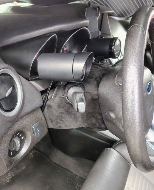

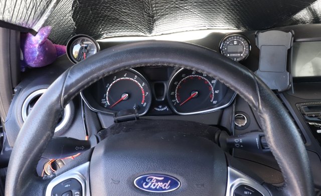

Tried a few different spots for my boost and ethanol content gauge. Kinda like the one with it setup in front of the cluster. I've also got a SVE double mount on the way I'm going to try out.
Wires would go behind the cluster on this one, I just was doing fitment feel.

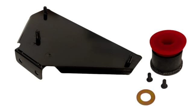

A bit of news, AWR is warrantying my whole mount and they have a new design they are sending out. This one looks to have the bolts on the side for the bracket instead of under the battery itself which would be a much better design with the forces on the battery for events.
That also means that community needs an update as all mounts online I've seen have the mounting points up top so we might have two versions on the market with stock on 3rd party vendors. Picture is how the new one is. I'll post pictures of the whole thing when it gets here.
That's awesome of AWR, I wonder if that was a common complaint of the original design...
