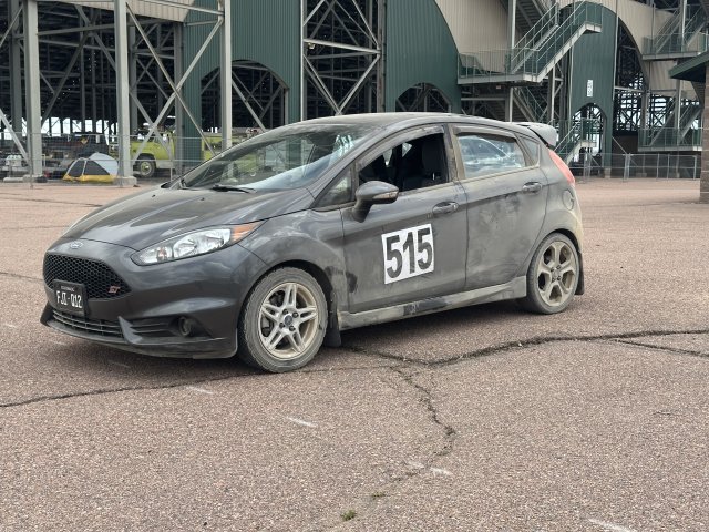

New tires are on, RE71RS 205/50r15. They are downsized from the RT660s I ran last time which were 225/45r15. They should be able to hold most of the power with the diff, but I'm still expecting some wheel spin if I apply way to much in 2nd. Went less wide this time to try and see how it helps with response. If they just don't work out I'll probably just start looking at going flares so I can fit something much meatier.
Are those the TD Classic Pro Race 1.2 wheels? I want TD wheels for my next set but am torn between them. Stock suspension?
312
444
Atlanta
Those are the original TD Pro Race 1.2s and the size on AA's ride (15x8, ET 35?) are the ONLY ones left which are able to be bought NEW.
Used, they might be found in 16x7 (very scarce), 17x7 (slightly more common), and 17x8 (moderately scarce).
The original U.S. importer (who was on this site frequently) was trying to get TD to cast 16x8s for us, but they refused since the demand did not seem to be overwhelming enough for them to bother.
Original TD Pros. I got 2 used on ebay and the other two were the white and silver from Phils Tire, which is why I have 3 different colors. Not sure if he had any others left. And stock suspension with 91k miles on it, only a Whiteline rear sway bar and some Moog camber bolts up front.

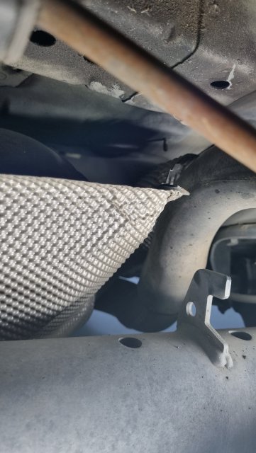

Chased down an exhaust rattle. Exhaust shop years ago didn't refit a nut holding on the heatshield (only 1 nut). It rattled for a short while then nothing for about 3 years.... now it's back!
I bought a flanged serrated nut hoping it'll just keep it it in place as all the others are present.
They look great.
