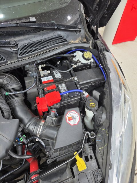

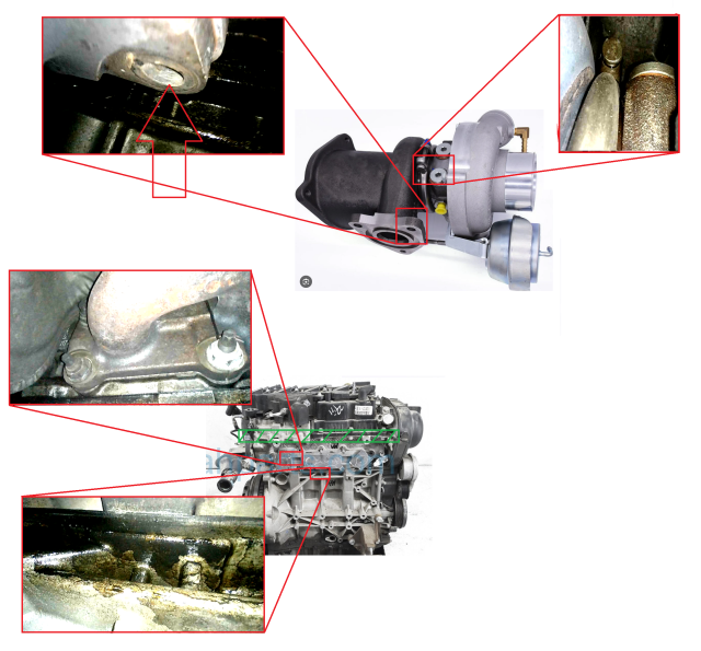

Believe I've found my oil problem. When I replaced the PCV hose I noticed I was getting some blue/white smoke, I thought I blew out a seal or something. I put the catch can in and it went away but the can wasn't the best for my power and I ended up removing it and just doing a straight hose with the UPR 100 psi check valve, and that seemed to work great but I started getting weird blue/white smoke and couldn't figure it out. Opened up the intercooler cold/hot sides and no oil there. Bought that endoscope and checked a few spots initially and saw some oil on the back under the valve cover gasket and thought I blew it out so I replaced that. Was still getting smoke under the hood and small buffs out the back and started to really worry I blew my hotside seals.
Well last night after a drive to warm up the car for fresh leaks I pulled the scope out and started looking for other oil spots. Well, I saw a big blob of oil on the backside of the block (Lower images) and could not figure out where it would come from, then as I was scanning the video I saw I'm missing a stud/nut for the manifold to turbo..
Which means my oil issue is I'm picking up and burning a butt load of oil through the PCV without the catch can installed (I checked the hose and it has so much oil in it) and I only didn't notice it for so long as my OEM PCV pipe had a tiny crack in it and was bleeding the oil into my engine bay ever so slowly as a vacuum leak. When I fixed that I happened to have a stud fallout of my turbo which caused the unburnt oil to spill onto the back of the block and slowly burn off, and what ever didn't get there was getting into my turbo and downpipe and slowly burning off there which would explain the absolutely random way the smoke would come out the backside under no set condition.
Answer, put a catch can back in and fix this darn stud.

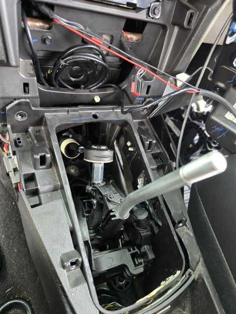

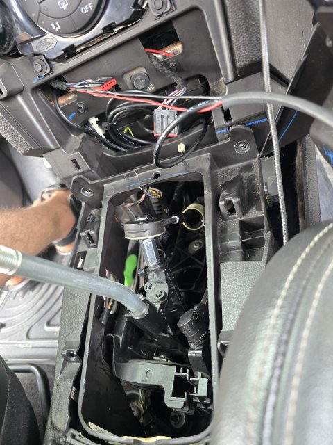

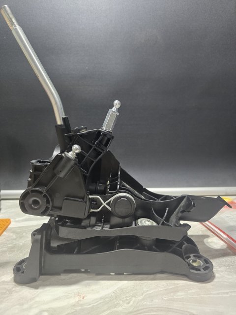

Melted out the old ball stud and added a threaded rod n bolt with a new extended ball studs on top. The clamping force holds it in good but imma add some epoxy as well. Hoping this works out if not I'll just have to reduce the length of the extension a bit. I got the idea from Reddit

Happy to say the shift ball extension works! Shift throw is much reduced and a lot notchier! Feels so much better and shorter. Also wired up my recaro seats so they are heated now 😀
It looks janky asf especially since I had to melt the old ball out but it's solid and works. I've been shifting hard and it's been fine

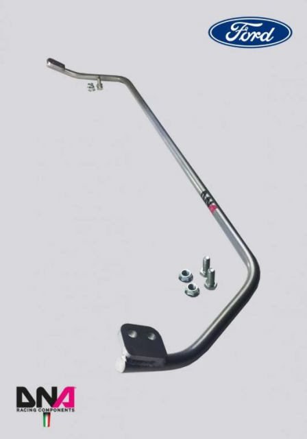

Installed the DNA rear sway/torsion bar. Install was 15 minutes.
So far after just a little driving around town, i can tell the rear of the car seems more stable.
Im glad it only took a short time to install...i started at 6 am and it was hot as balls by the time i was done.

What year is your fiesta? I have an '18 with the stiffer rear beam, I've been wondering if it would be worth it for mine...

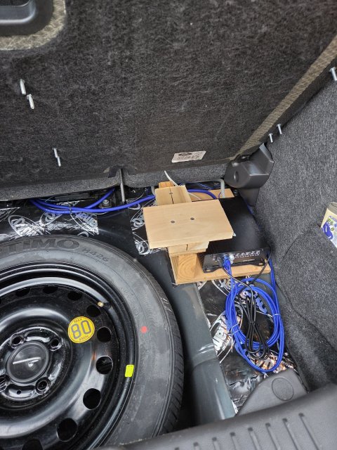

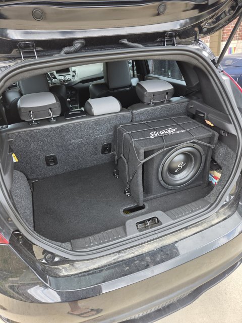

Last weekend I installed a Stinger Audio 10" party pack, a 10" subwoofer and 700 watt amp. It turned out pretty well. I built the amp rack from wood scraps under the false floor with a support to help support the weight of the sub. I will build a nicer amp rack at some point, lol.
The sub is held down with a motorcycle bungie net and tie downs bolted through the floor.

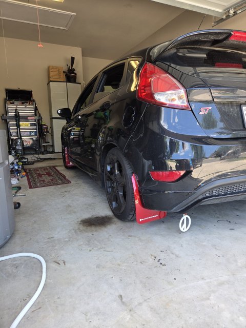

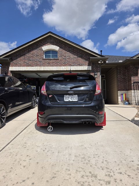

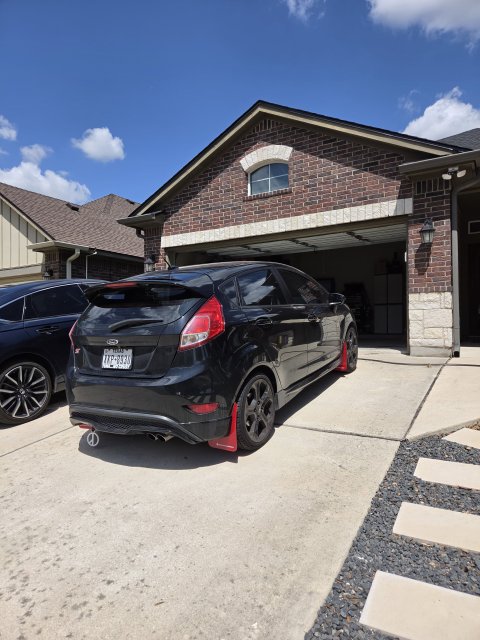

Today I installed Rally Armor mud flaps. I heard the install was a process but it took me 5 hours... I do work slow, though.
Looking forward to a skid plate next then getting back into rallycross! (the tsurikawa and subwoofer will be removed for race days, of course)
Looks awesome. Those rally armor flaps take a ton of time. I took my red ones off, and tried to dye them purple (spoiler: didn’t work. They’re mostly black with a few red stripes where the dye didn’t reach). I pulled a gardens worth of dirt
That was packed behind the flaps.
