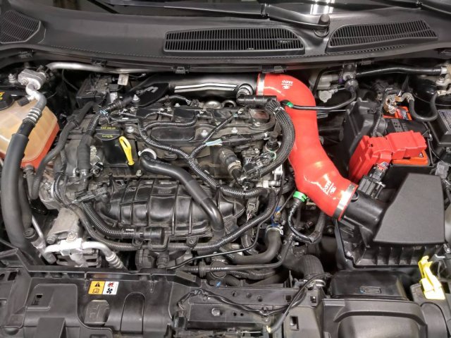

Installed the new Mountune crossover. Nice oem+ look. Will have some full pics later after the car gets reassembled. Also, cleaned my air filter but found a bunch of gunk in the pleats after multiple washes. Going back to paper to avoid the headache. View attachment 37689
Nice part! However I do not see a real benefit of that part vs the Whoosh regular crossover...half of the price and do the same?
340
183
San Francisco Bay Area
I don't think there really is performance benefit of any of the crossovers. This replaced an ITG crossover and fits much better since it has compound angles vs just a bent tube. Honestly I bought it for looks and brand consistencey in my engine bay. It really makes the engine more presentable when not running a cover.

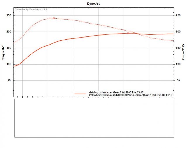

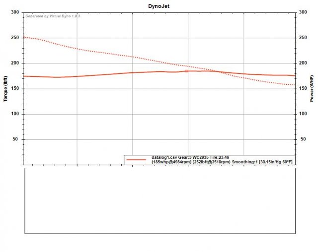

Installed vdyno and did a comparison of power output with and without an exhaust silencer in a 2.75" Tsudo catback which I'm not the greatest fan of lol. Datalog with silencer installed accidentally began at 3500 rpm so peak torque may be a wee bit higher in that run but it shows the 11 whp loss up top. Both runs were made within an hour of each other and on the exact same stretch of road. Also SAE corrected and as accurate as I could make them. The only stock exhaust datalog was taken at 90 degrees fahrenheit in summer so I couldn't add that for an accurate comparison. Only other mods are a glorious Dizzy Stage 1 tune with colder plugs and a Ramair filter. Cheers
Temp: 60 degrees Fahrenheit
Gear: 3rd
Altitude: 49 feet above sea level
